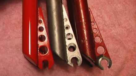

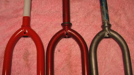

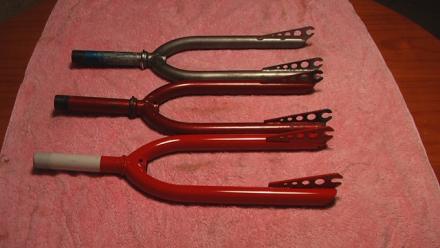

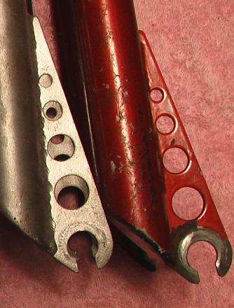

I love a good early days of BMX puzzle. A lot of confusion about early SE forks, and Cycle Pro forks. So, I decided to jump in and see what I could figure out. Lots of reading, lots of PMs with folks, lots of pictures. Heck, I've even bought multiple forks to be able to do side by side comparisons and take pics! But, I think I've pretty much got it sorted out. Maybe I'm wrong, but, I trust folks here won't be shy correcting me.
First, we have to talk about Race Inc. Prior to manufacturing SE bikes, RI was making bikes, branded with either Race Inc. or Cycle Pro (and sure, FMF before). And, those bikes both had forks. Which forks? Well, we're only talking about the leading edge fork here, which ended up being the SE fork, so, we're dropping the straight leg out early. So, here's our first point. Race Inc. made forks early. Both RI and Cycle Pro branded. The first problem we see starts here, the only difference between them is the stickers. I own both of these forks, and this picture is an RI and an early CP fork side by side. My forks don't have stickers any more, but, the fork on the left is Cycle Pro, on the right is a Race Inc. fork. RI forks were not drilled, but, this one was drilled by a prior owner (you can tell), and did come off an RI complete, so, although there is a drill hole in it, it is an RI fork. Unfortunate, but, that's life. And research. Notice, they are identical in shoulder shape and dropouts.
Starting in 1978, with SE and the JU-6 and BD-III, and later the PK Ripper and DB-IV, SE also branded the same fork with SE/BMX Innovations stickers.
So, at this point, we now have one manufacturer, with one fork, yet, 3 different brandings. RI, CP, and BMXI.
And now it gets even more confusing. Because it appears with RI taking over SE manufacturing, they quit making Cycle Pro stuff. You don't see the Foiler or Spoiler anymore! And, likely the RI made Cycle Pro fork went away. But, we have Cycle Pro forks appearing as late as 1982. Where did they come from? As early as January, 1979, we start to see Cycle Pro forks that are manufactured by Tange. So, it appears CP went off to Tange to manufacture a fork, in general, with the same overall specs as the RI made fork. Check out a Tange fork on the left vs. the RI made forks. Really close, but, a bit different. The shiny red fork is an NOS Tange made Cycle Pro fork, stacked up next to the other 2. Note the dropout is almost the same, and the shoulder is almost the same. Almost. But, look closely, they are distinct.

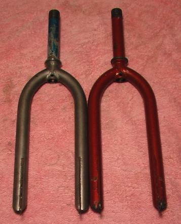

I have documented 2 Tange made Cycle Pro forks, with 9A stamps, nothing earlier. And, I've seen that fork stamped as late as 2B - Feb. 1982. So, Tange made Cycle Pro forks from 1979 to 1982. I'd expect with the LG fork coming out in 81 (or so), the market for CP forks dried up.

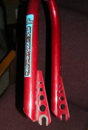

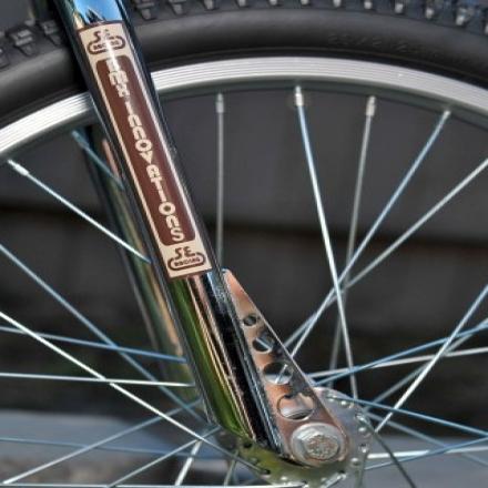

Could it get any more confusing? Well, of course. SE still needed a fork until the LG was out. So, how about we slap an SE/BMXI sticker on a Tange made Cycle Pro model? This is the same fork as the shiny red fork above. A Tange made model. The only difference, the sticker.

I hadn't considered 26", but, there is nothing unusual about either of those decals on Tange made forks - Tange forks could be SE or Cycle Pro badged. I edited in another photo above of the SE and CP Tange forks with OG stickers on them. That's really the whole point, it's just stickers setting these things apart. You either have an RI or Tange made fork, and then a Cycle Pro or SE sticker applied later.

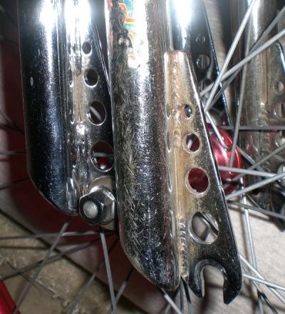

Early non drilled fork I have owned since new (circa 1978)

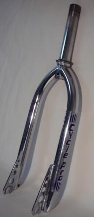

The earliest Cycle Pro forks i own, i've only seen these in a 1978 Minicycle bmxaction magazine product review.

Race Inc forks?
Mark Mc
Mark Mc
  • Supporting Member
  • 1,191 posts
Yep. The shoulder width and dropouts are the Race Inc made version.
Now, in all fairness, since early Cycle Pros were not drilled, they could be Cycle Pros. But, since this style fork was Branded as Race Inc from 77-84, it's most likely, since it's not drilled, Race Inc.
z-man99
z-man99
  • 889 posts
I was sure they were Race inc then I remembered that I have an nos Cycle Pro Decal. My new decal compared with the remnants on the fork:
I'm sure others have already figured this out but for me it was first hand evidence that the same exact fork was labeled Cycle Pro and Race inc, and probably SE Innovations, too.
