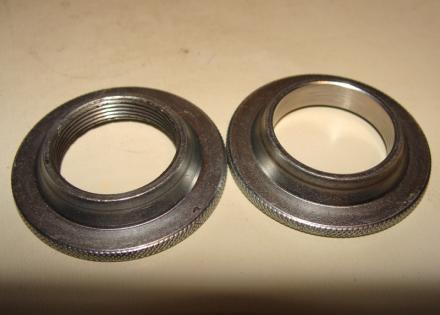

Do I have to have a special headset for the girder forks?? :Idunno:
#82
Monster-Robot
Monster-Robot
  • 2,337 posts
Use a Wald, the kind with the flat top race. You will need the thinnest parts possible for the top especially the upper race. A Schwinn will be too thick.

:rockout: Thanks Hector...now where the hell do I find one of those?? Never seen one with a bottom race like that. :blink:

Posted Image Thanks Hector...now where the hell do I find one of those?? Never seen one with a bottom race like that. Posted Image
Got your PM Brett. I used two Wald head sets and made up one Matthews head set. Matthews used Wald components for their forks originally. I took one of the top threaded bearing cones and ground out the threads untill it fit over the 1" steer tube to make up the bottom cone. the rest is pretty strait forward.
#86
bmx2112
bmx2112
    ya dig!
  • 10,835 posts
Thanks Sod, yeah that what I was thinking I was gonna have to do for the bottom race. :OSThumbsUpPeace[1]:
